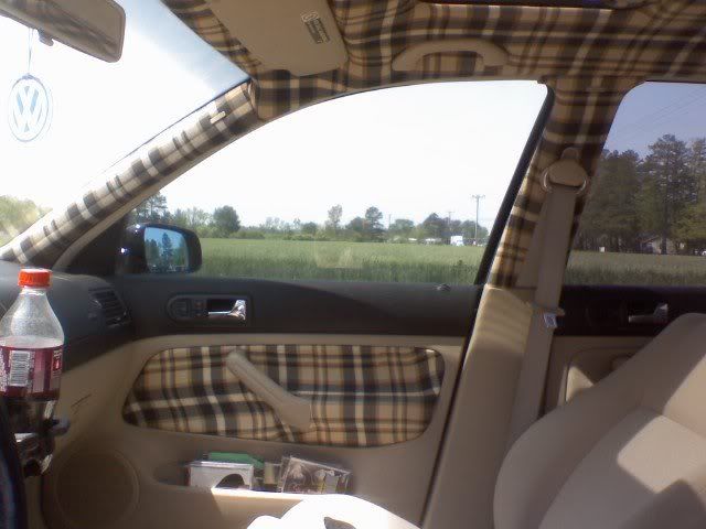

i used Landau Top and Trim Cement on my head liner, pillars, door cards, and rear deck. it's sprayed out of an air gun, and its the same shit they use to put vynl tops on cars. havent had any falling down in 6 months.
That's the good stuff, I used to use that for all the car audio carpeting and vinyl work I used to do. Nice green stringy snot.
It doesn't, however, make up for the fact that you have the ugliest interior I have ever seen.
