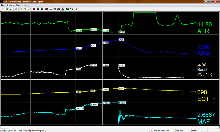

Attached to this post are two screenshots from the datalogger during my dyno pulls at Adrenaline Autoworks.
