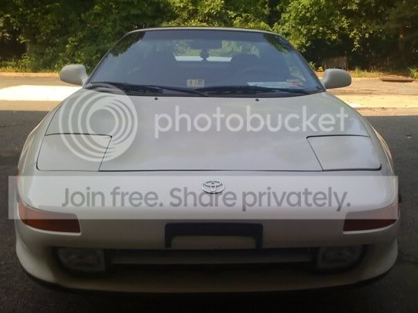

Car off..
Normal beams, passenger normal beam out, driver's side won't flip up, but........
Still shines...
High beams......wtf fogs don't work? Don't know if they're even connected..yet again, know nothing about wiring and electrics.
Right running light out, left brake light out. fuuuuuuuuuuu....

If one headlight goes up and the other doesn't, I'd check the wires for voltage to make sure it's not a bad ground on the motor. If the motor gets power and doesn't move, it needs a new motor. Check the fuse box, I doubt it but there just might be a fuse for FL (Front Left) headlight and FR (Front Right) Headlight.
