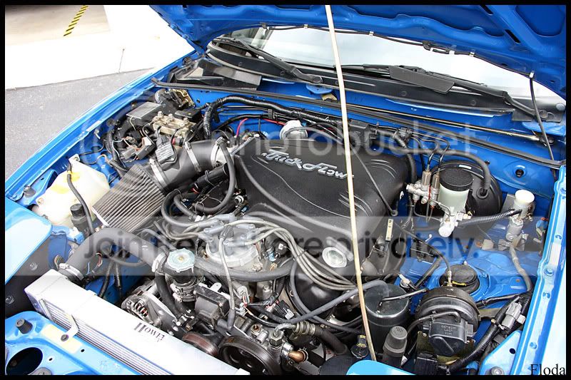

LOCO, i did some research on the rear ends when i was looking into puttin the vg in my miata, the rx7 rears can be done but take a little work and are pricey, a stronger, lighter, cheaper alternative is a lincoln ls rear diff & modified thunderbird / cougar axles and hub assemblies. itl take the power of a heavily modified V8. you oughtta ask kevin whats done for the rear end in that sb ford powered miata they have at PAS.
Good luck with the swap!
This is a solid rear axle? If so go with the rx-7

Nah its independant. its an aluminum housing with a LSD, 8.8 gear's, the thunderchicken / cougar axles bolt right up to it. swap to those hubs, have the holes welded closed and redrilled for 4X100 and you got a SOLID rear end! the mounting brackets arent to hard to do either. i am looking now for pics of it i found.
