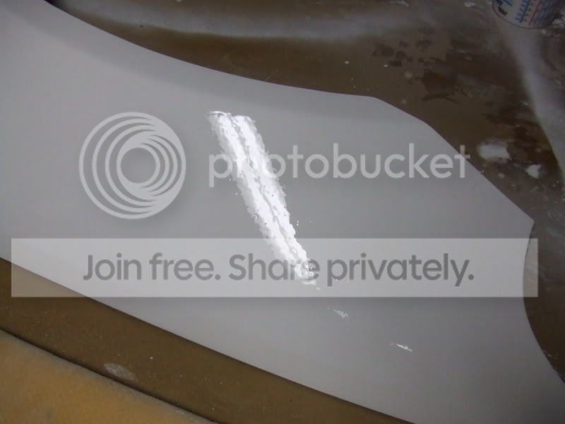

Originally Posted by sive ick
well you said you sprayed your,im talking about roll on paint
here's a rolled one from honda-tech
another (not shown with the final polish):
another:
another:
i'll stop there. the paint comes out good whether you spray or roll. is just takes a lot longer when you roll it.
wow man thanks for finding pics,im thinking about doing it but i read how time consuming it is and if you mess up once,its done your fucked
you're not fucked. the amazing part about this paint is that you can sand it down and try again, at the max you'll lose like $10 and a couple of hours of labor.
it's really inexpensive and theres great results - you just have to put in the labor to make it look good.

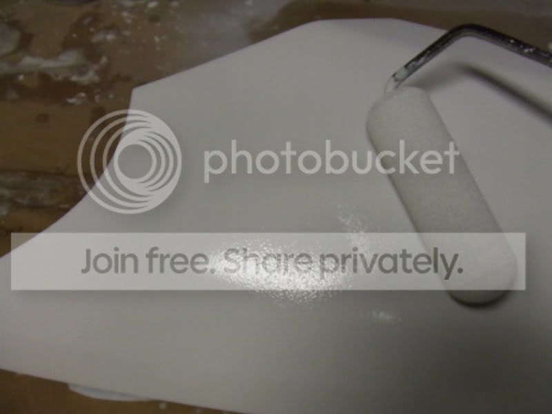

Originally Posted by g S x
shit yea thats what i'm talkin about.
if thats really rolled on, then you didnt thin the paint out enough. you need to thin it out enough that the paint will self level.
I didnt this a few weeks ago to my Jeep. good results.

Originally Posted by XCELR8
Am I reading this correctly? You people are painting cars with a roller?
yes you are
you use a high density foam roller and rustoleum paint
thin it out so it self levels and roll on 2 coats then sand
2 coats and sand 2 coats and sand
then finish with 1000-1500 grit sand paper and a polishing compound
