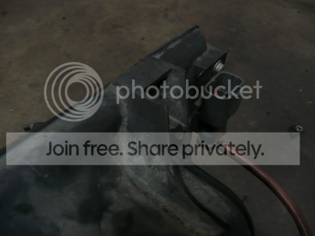

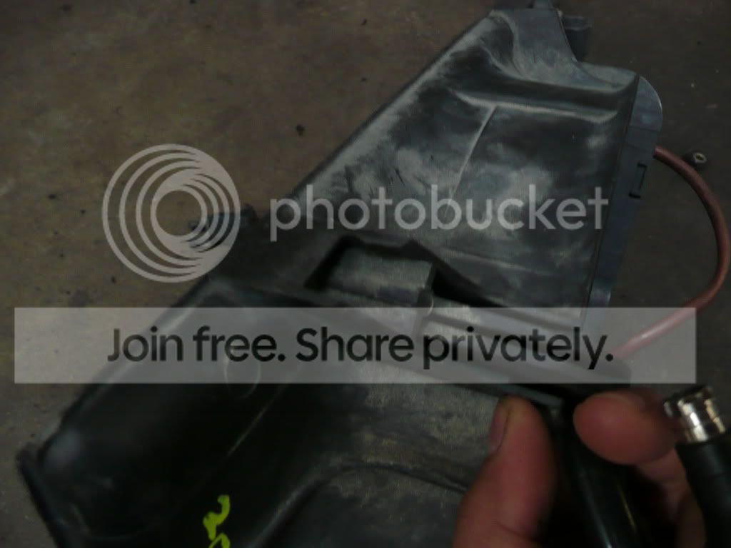

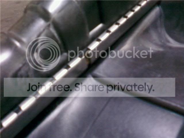

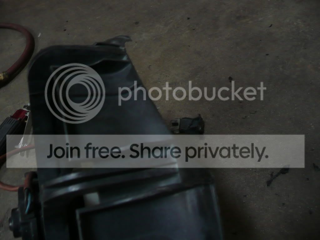

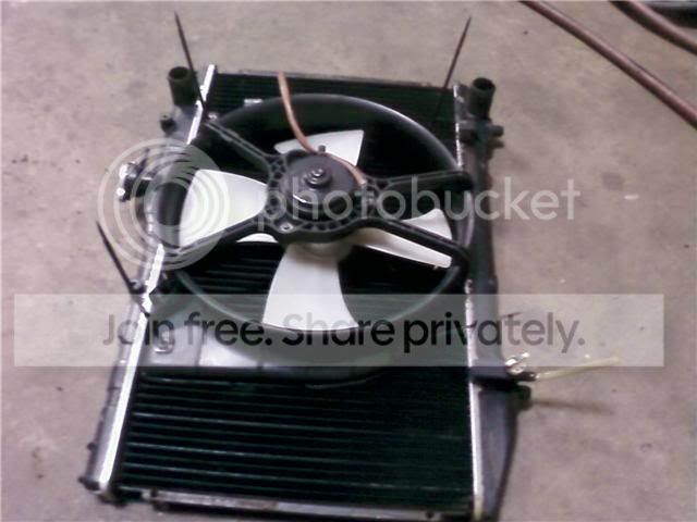

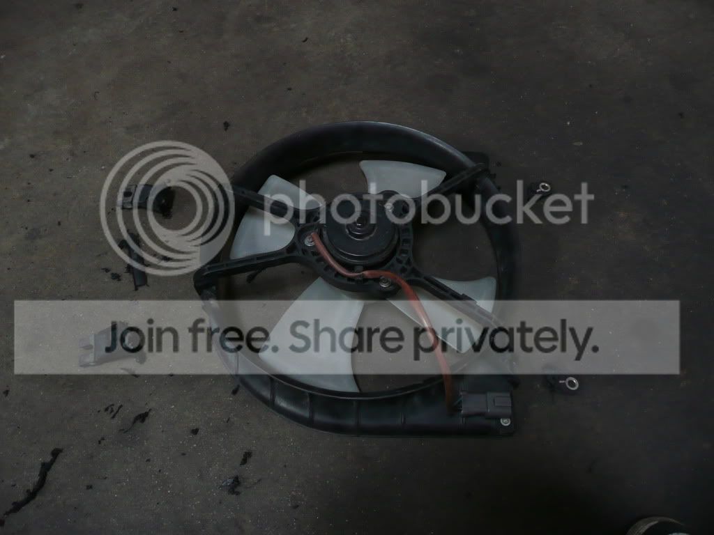

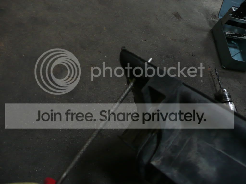

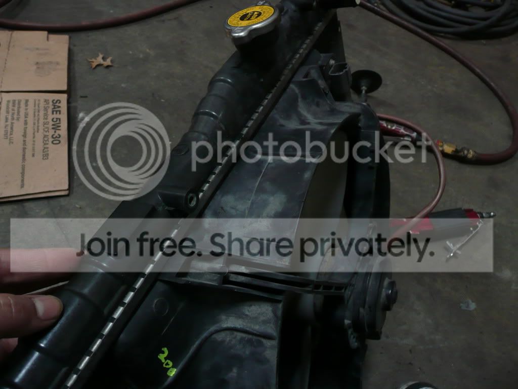

Take the distance from the radiator core and cut off the upper tabs and lower section of the fan so that it sits flush against the core. Clean up the burrs using sand paper, wiz wheel, or a file.

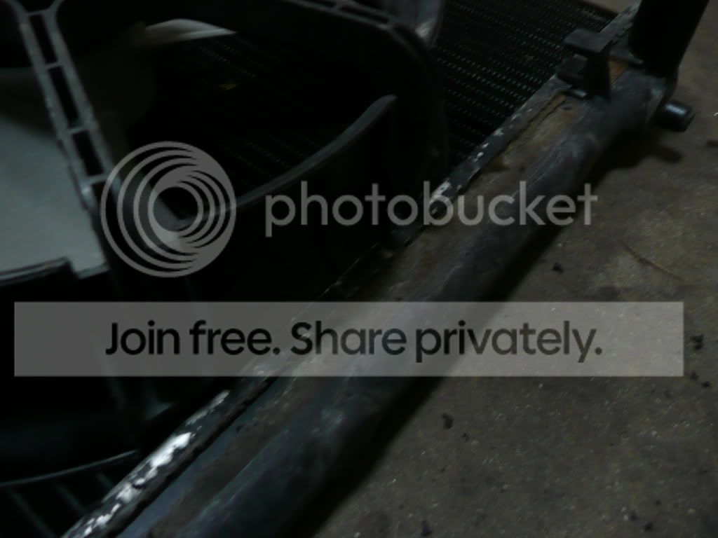

Line up the fan where it will be center of the radiator(there should be a marking on the center of the radiator and the fan)

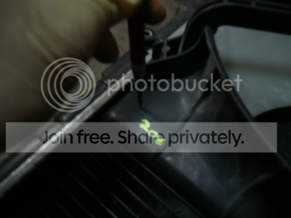

Use a center punch to mark where you will be drilling the fan where it will not hit the fan blade and the core of radiator( the fins does not hold coolant)
Clean the holes up with a file.

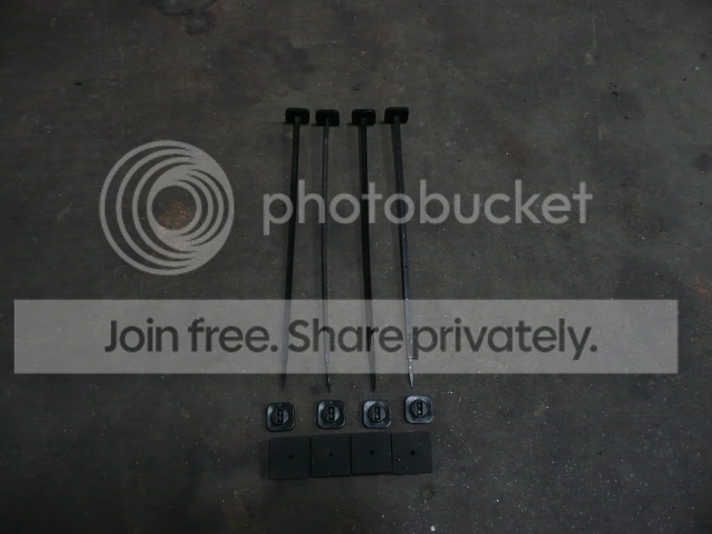

Use the fan mounting kit(don't for get the mounting pads- you don't want to have the radiator core damage from the vibration while your driving) Also cut off the extra of the mounting strap.

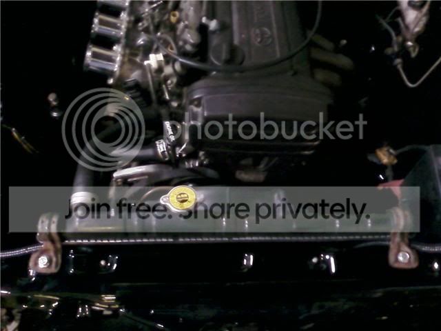

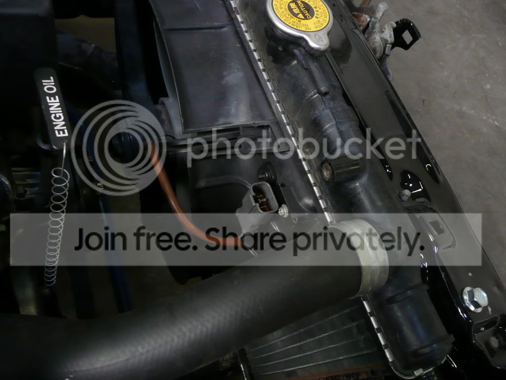

Reinstall
Then wire up your fan and enjoy.
