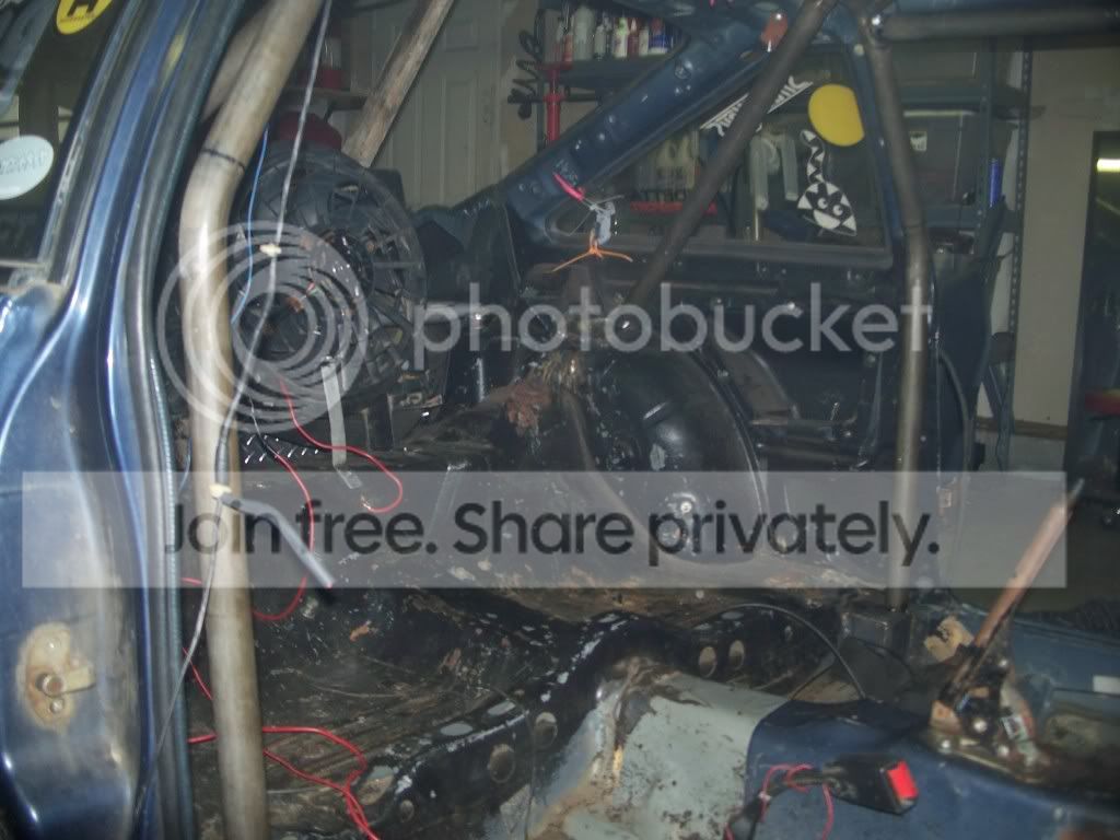

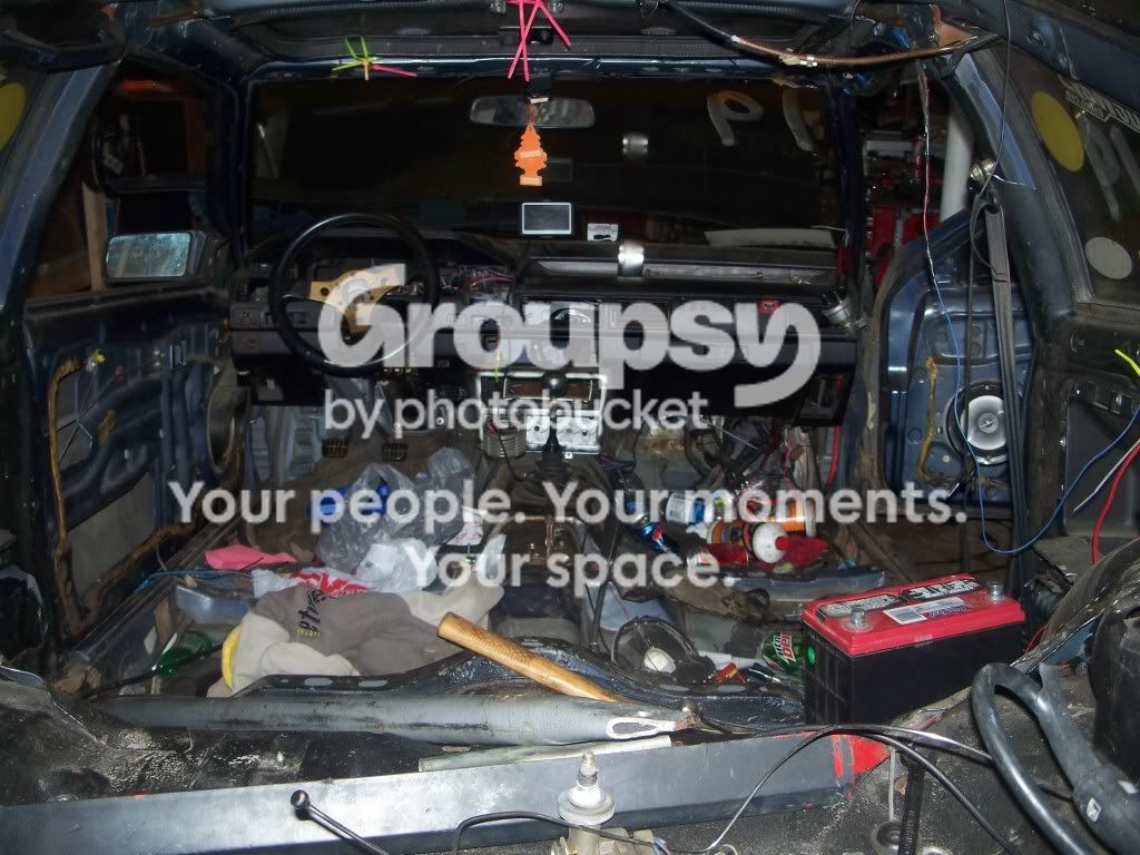

k time for a real cage

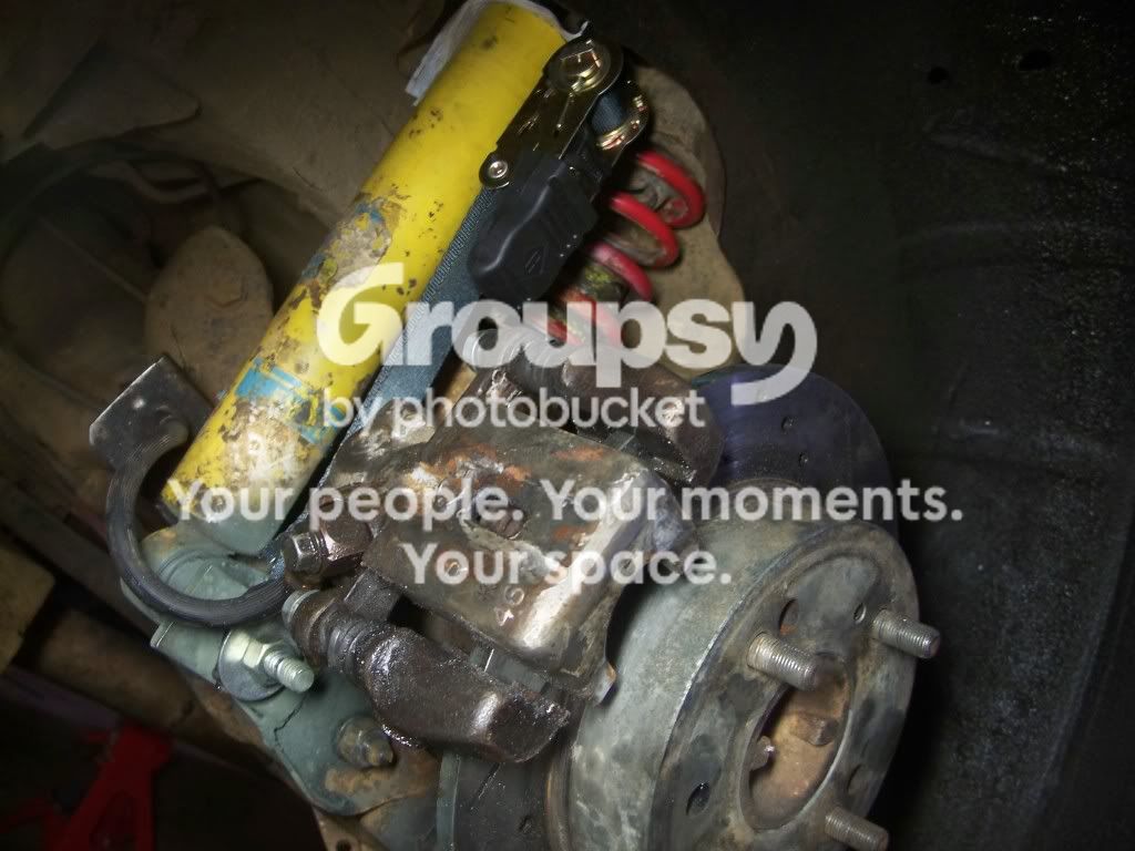

lowerd the car a inch and lowered my shock mount

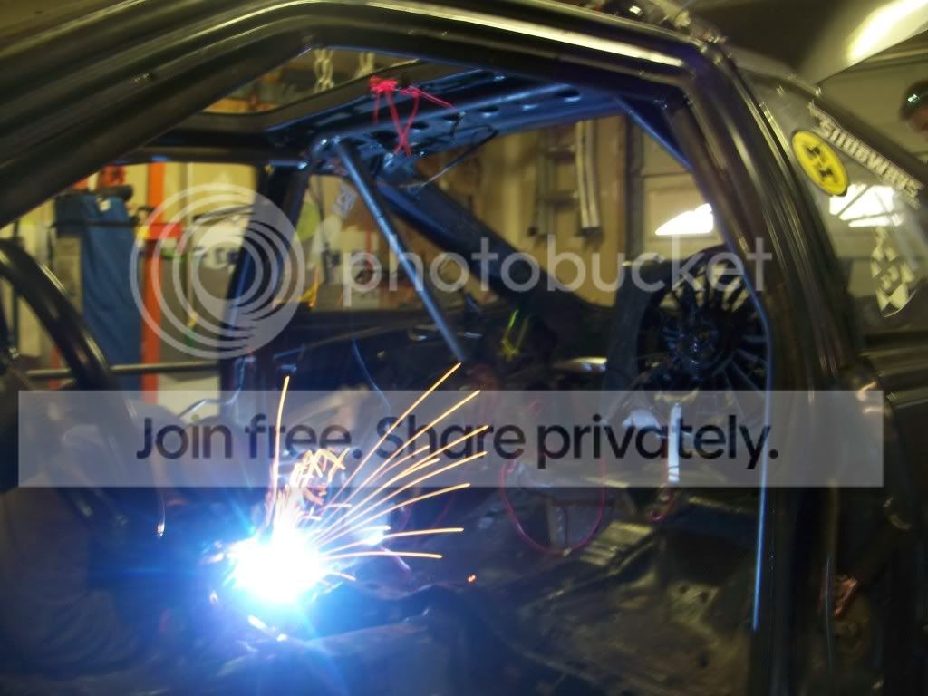

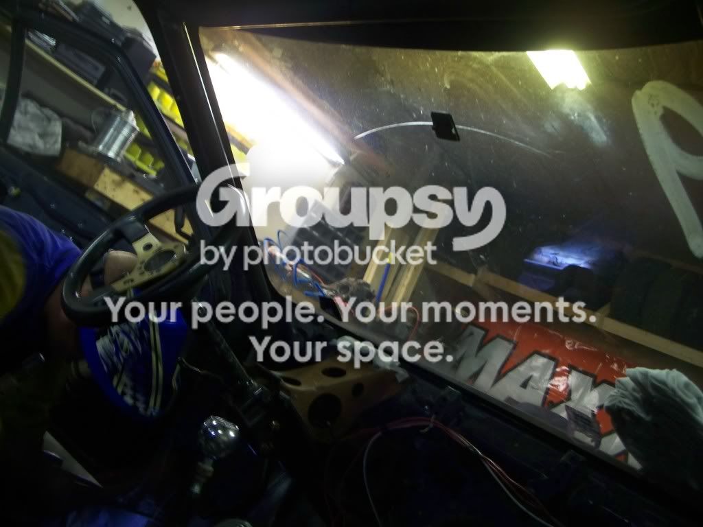

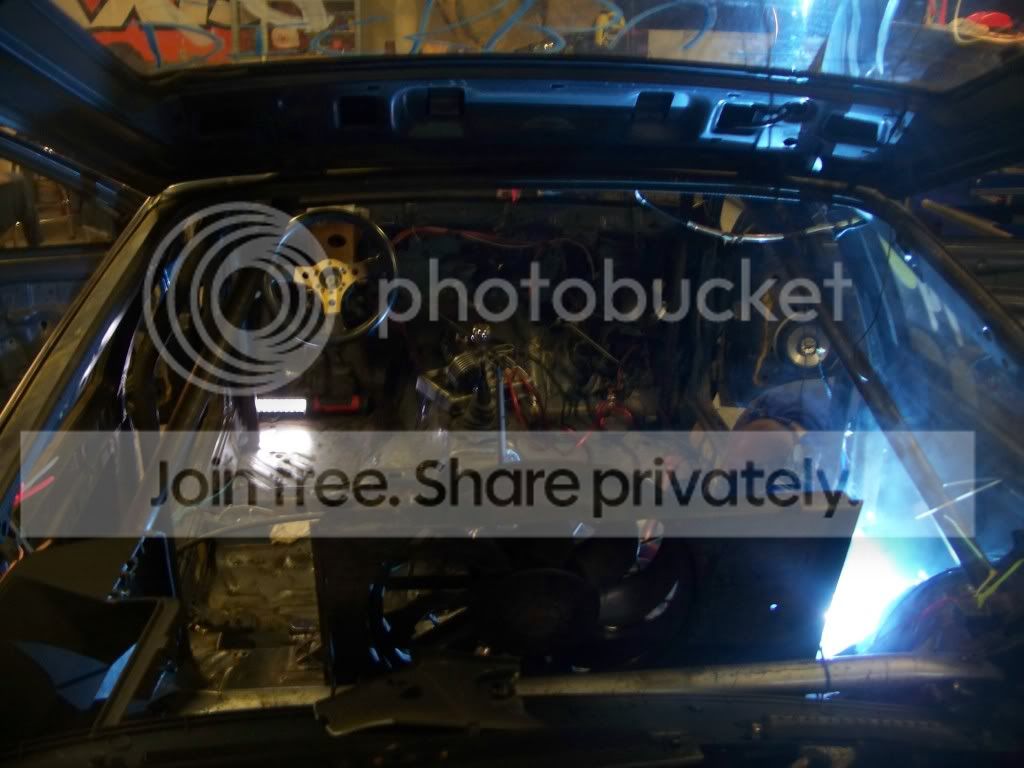

i stopped by to check out the work, lee started yesterday and has made tons of progress. he hadnt welded anything in yet till i got there. hes still working on the final fitment
diagonal bar, harness bar, drivers barr, and passenger bar yet to come
yum

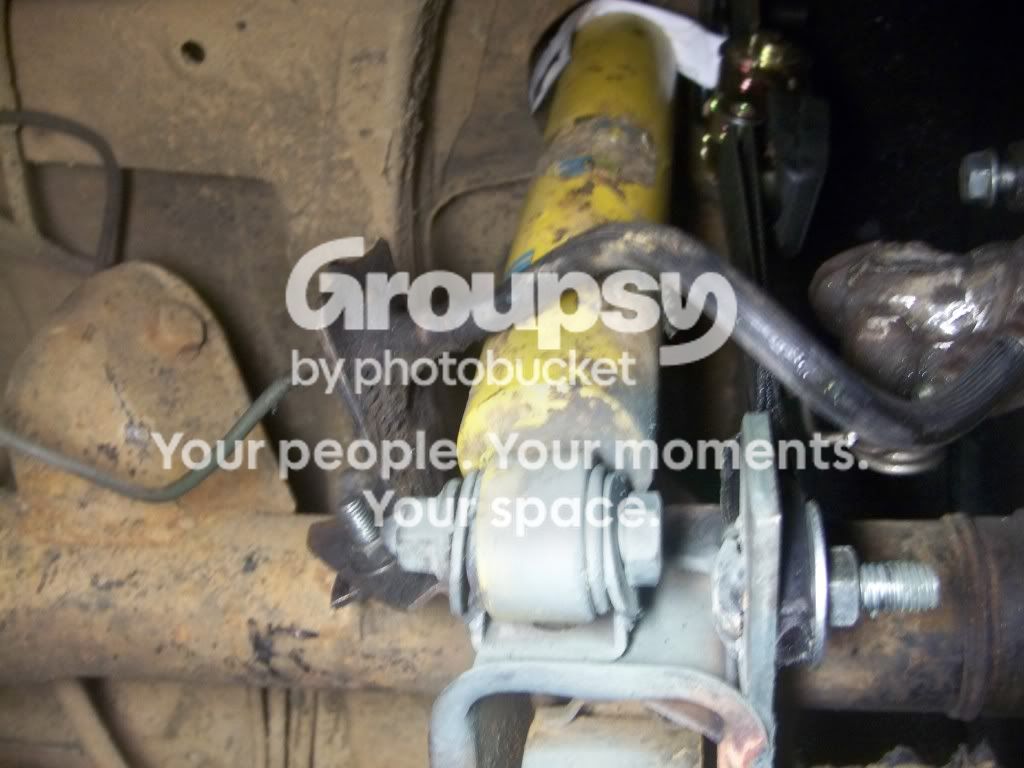

Glad to see you're putting a real cage in!

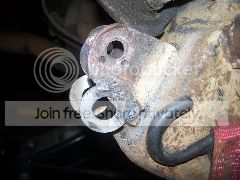

Please explain this:
http://i367.photobucket.com/albums/o...w/129_4302.jpg
Looks like a super ghetto way of lowering the shock mounting point to raise the axle, making the ride height lower. And by super ghetto I mean way more ghetto than anything else in this build thread. Bad things will happen when that breaks.
I'm all for ghetto solutions, but unless I'm seeing it wrong I don't think that's very safe.

Haha I was thinking that as I posted . "Not very safe" is a relative term. I haven't paid that much attention to this build, but from what I recall this new shock mount is far more dangerous than anything else done to the car so far.
I don't think the tensile strength of those washers is high enough for the load they will see. They won't just have downward force on them either, especially since they are welded at angles. Once one breaks, the other one will be soon to follow.

the load of the car is supported by the springs, that shock mount sees as much play as the shock lets it... the washer i welded onto that is more thick then the stock stamped steel... regardless that was temporary and has been reinforced.
ive already done a drift event with it regardless at drift nirvana civil war last event, placed second!
