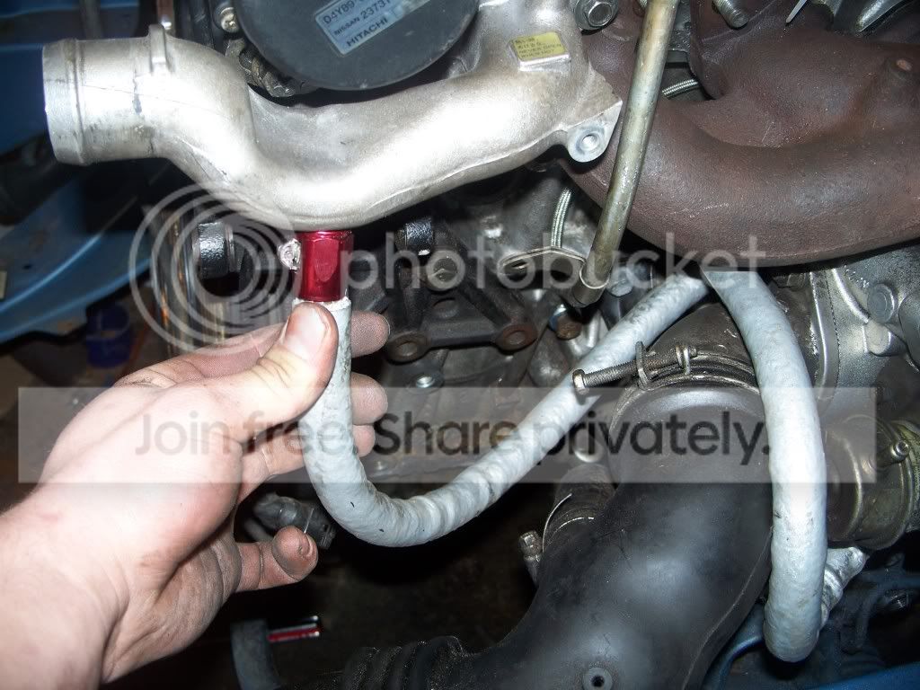

okay, i want to figure this shit out

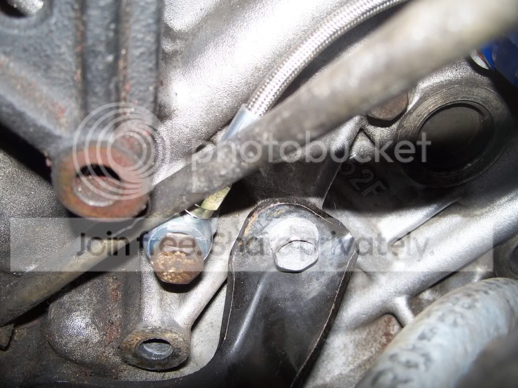

theres, oil return, thats the nipple on the bottom side
oil feed, thats what i think its the banjo line off the side of the block
coolant feed, thats the larger banjo fitting up the block towards the head
and coolant return!?! people said the back of the block. I CANT FIND THAT LINE
but, could i just tap into my upper rad hose neck? yes no? just put a fitting into it?
heres my coolant feed, i think. in the backround is my oil feed...
closeup of oil feed (wrong size banjo bolt, its just there for the picture)

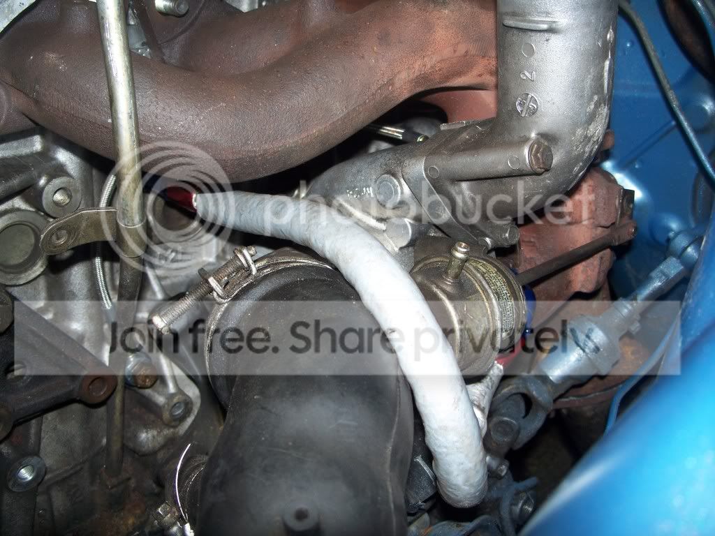

and whhat i want to do for the coolant return
or is there a more reasonable place i can do it? i like it there. but i dunno if that will work,
i dunno, is there supposed to be a specific path/direction of the coolant flow?

Get an s14 SR coolant neck. The fitting is already on there.

yup. best bet

im broke atm i dont feel like buying one

put a fitting on there.
still need to locate where it was supposed to go, in the rear somewhere. so i can cap that off

Yeah its in the back near the heater core lines (pretty sure).
You'll be so happy you have that line there when you ever pull the turbo/manifold out and its all right there and easy to get to!

Stephen is right. That line usually is tapped of the rear line that goes to the heater core. Im guessing you tapped that and threaded in. Looks good.

okay, just to confirm.... i have NO heater core lines on the back (for the moment)
so if thats so, that means, thats why i couldnt find a location in the first place, because its part of the heater core line assembly?
just wanna make sure theres not a fitting im missing so when i start the motor coolant will come flying out somewhere back there
im just gonna run the heater core lines together
im on the lookout for a banjo bolt for the oil feed line. are they the same as turbo z32's?
